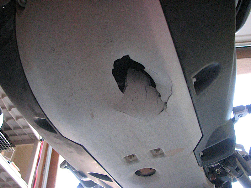

    Standard guard is a dust-cover at best. A decent-sized stone flung up by the front wheel will punch a hole in it.
    A 200kg bike has a lot of energy to dissipate when it comes down on something immovable.
    Here is my bike after a hit on a rock.
    Now, lets look a little closer ...
    All of the the all-aluminium ones I have seen will bend like that if they take a direct hit. They all bend a little too easy IMO.
    For all the shit that Touratwat sell, their sump guard with the steel subframe is actually pretty good.

    I think your bashplate did its job well Mooky. Better beating the plate back into shape than having the impact transmitted through to engine casing. I'll go with the Alu every time.
