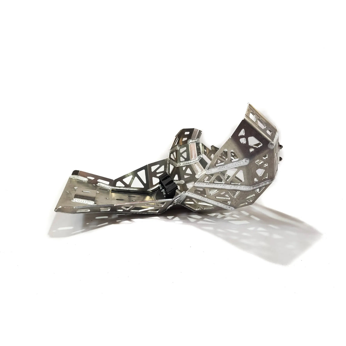

Picking up a 23 TPI tomorrow and figure I'd do well to not only fit a bash plate but some exhaust protection. I imagine I'll be picking the bike up quite a few times at places like Tong and Cowm.
Any opinions on these single piece ones? Or am I best getting a bash plate and seperate exhaust cage?

I had the bottom skeleton type on my TPI but conscious of the damage to the frame paint where it mounts. I wrapped inner tube around the frame. Honestly I wouldn’t bother with another for the reasons Grant gives above.

Skid plates, I’ve got the aluminium power parts one on the EXC and the plastic one on the SX, which is OEM but really Acerbis I think. If you hit the aluminium ones hard enough, you can bend them. Easy to straighten in a vice but a faff, can buzz too.
I’d go with the plastic ones going forward… got the beaver tale one on the SX. Not a fan of those big exhaust cradles, as above.

Bashplate I have aluminium from EnduroTek Over time it has taken all the paint of the bottom of the bike. But it doesn't bother me. Maybe you could stick some rubber to the bottom of the plate to stop this. I don't know. I hope that helps
