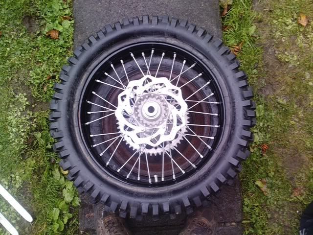

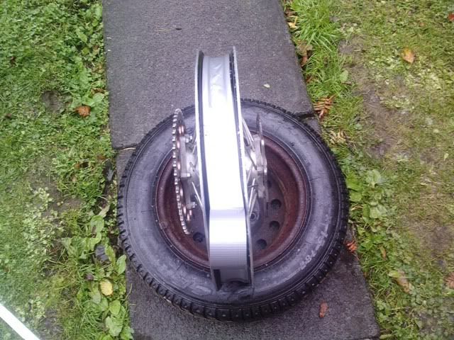

I was changing my rear tyre today which has a mousse fitted and I thought I'd take a few photos as I went along and show how I do it.
The method I use might be different to what others do but I find this way easy and it usually takes me about 10-15 minutes to change a tyre over.

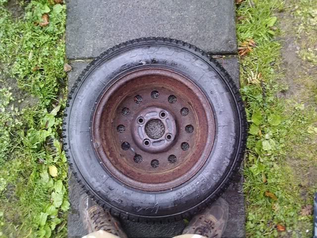

I don't have a bead breaker or mousse board, I use an old car wheel with the tyre still fitted to sit the wheel on
Also I use a wee selection of large and small levers, a bead buddy and a couple of blunt chisels

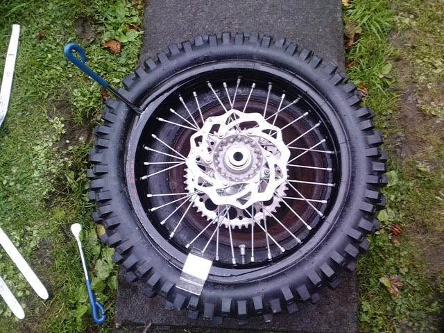

First off I sit the bike wheel on top of the car wheel, sprocket side down (this stops you losing your knuckles) and loosen the rim lock to the last thread and sit the rimlock at about the 3 o'clock position

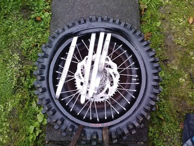

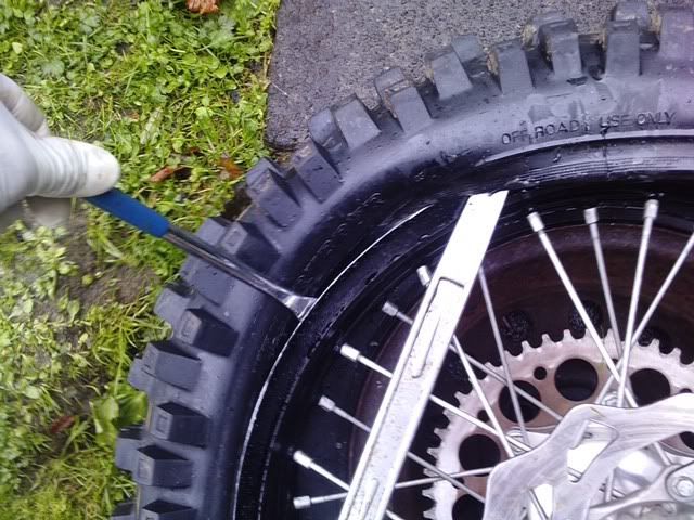

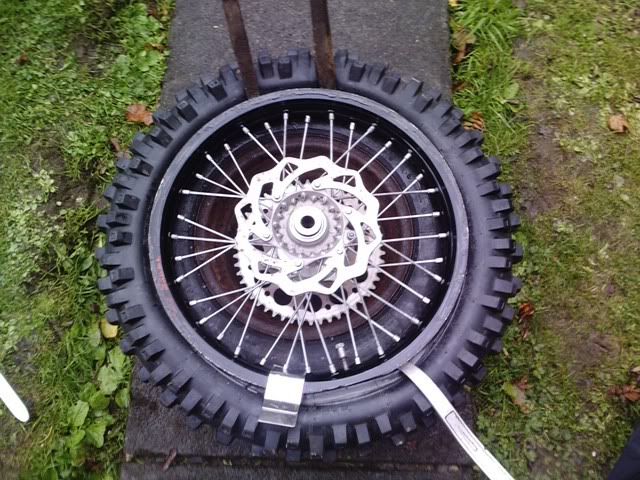

I then use a small lever to prise the tyre out so I can fit the chisels into the tyre at the 6 o'clock position, the chisels force the tyre's bead into the well of the rim making it easier to remove the tyre

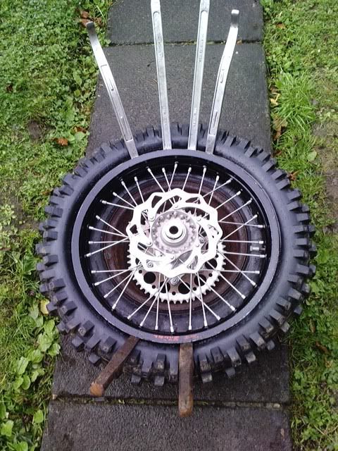

At the 12 o'clock postion I then fit 4 larger levers

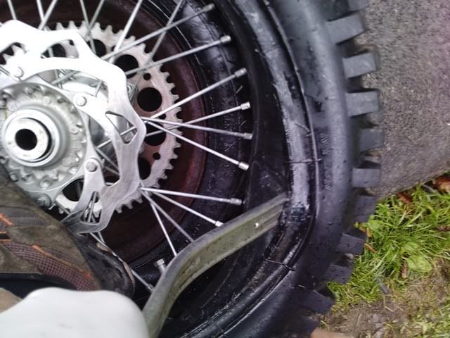

Then I put my foot on the brake disc to steady the wheel and pull on the large levers one at a time, levering the tyre off
Next I use a small lever and work my way around the rim removing the tyre

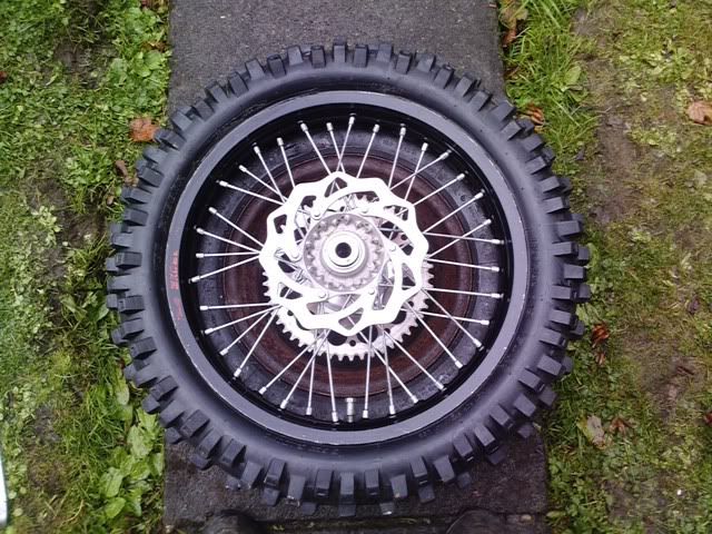

First side of the tyre off the rim

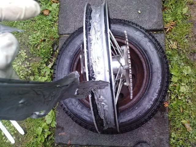

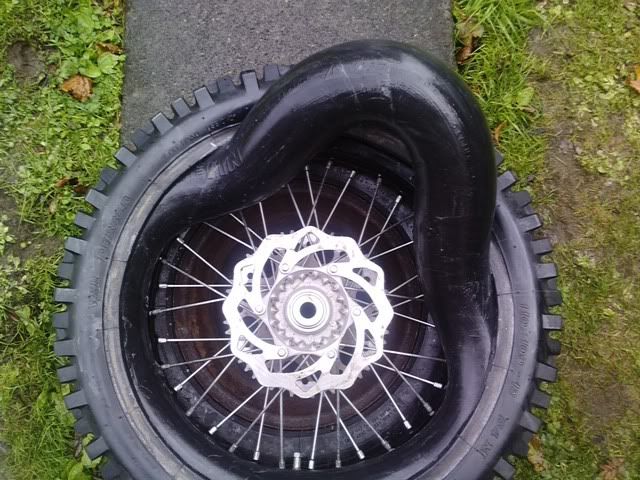

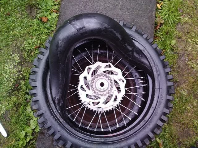

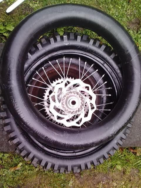

Then I stand on the wheel and pull the tyre upwards, this pulls the mousse out of the wheel rim
Mousse still in tyre and ready to be removed
I then use a lever to prise the mousse out of the tyre

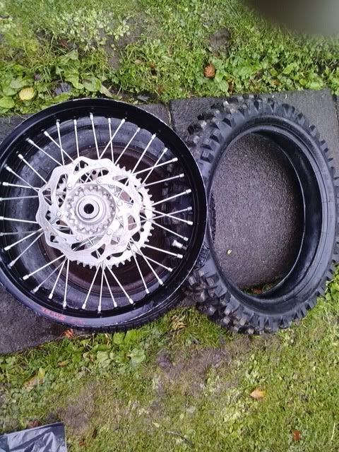

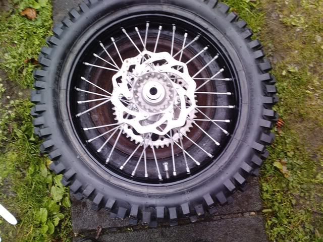

Next I flip the wheel over and remove the tyre from the sprocket side of the rim and then remove the tyre from the wheel

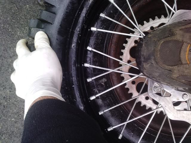

Now I pull off the old gaffer tape that I use instead of rimtape
And fit new gaffer tape, I wrap it around the rim twice

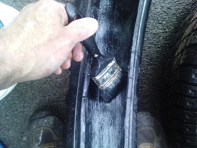

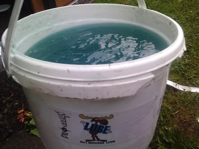

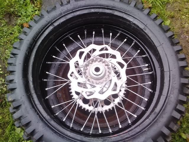

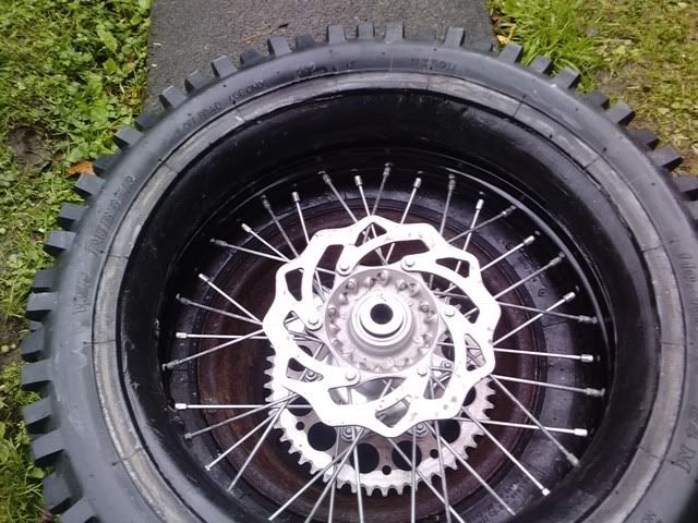

Next I lube up the tyre I'm fitting, recently I've been using ProClean Mousse Lube and apply it using a paint brush
I then fit the first side of the tyre to be fitted, again sprocket side down
I then refit the mousse into the tyre

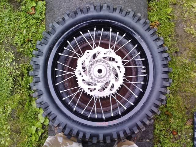

Mousse fitted in tyre

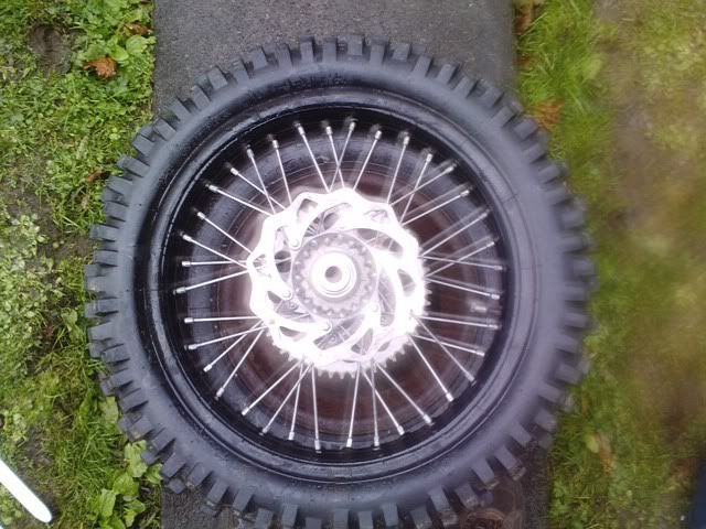

Now using my knee I press down on the tyre going around it forcing the mousse into the well of the rim

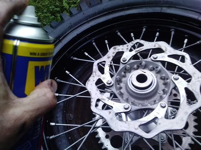

For lubing up the bead of the tyre I use WD-40

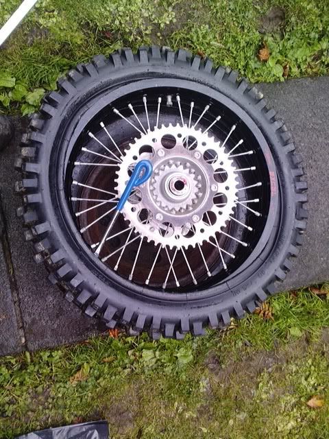

For refitting the brake disc side of the tyre I have the rimlock at the 6 o'clock position and start the tyre off and fit my bead buddy just to the left of the rimlock

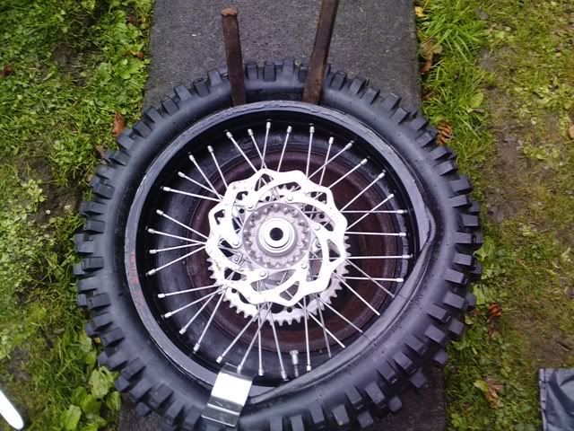

I then keep fitting the tyre until it starts to get too tight to fit any more, then I fit the 2 chisels again to push the bead into the well of the rim, this time I fit them opposite the rimlock
This then creates enough slack on the bead of the tyre to fit the tyre the rest of the way around
Now I remove the bead buddy and whilst pressing the rimlock in with a lever I pop the final part of the tyre in (didn't have enough hands to take a picture whilst doing this)

nice one donny, have you nipped the mousse in pic 12, bottom left?

Hi Brian, good spot, yeah got it caught in the rimlock a few changes ago :redface:

Nice pictures, I use a metzler mousse board myself. You could proably shave some time and effort from your changing by leaving the mousse in the tyre until it's completely off the rim. Saves nipping it with levers.
With the tyre off one side, stand the wheel up and lean it against your knees, that side. Then you place a lever under the edge of the tyre that is in the recess where the spokes are and then push it over the rim closest to you legs. Pull the lever upwards towards you and the whole tyre and mousse come over the rim. Kneel on the tyre and off it pops. If you don't want to use your knee a few taps with a rubber mallet and its off.

Have you tried using glass cleaner instead of WD40, it is slippy enough but evaporates to leave no residue and helps to stop the tyre slipping (even when using a rimlock)
34 Posts
Great walkthrough thanks. Going to attempt changing my tyre the weekend but wasn't sure on the mousse as it's my first one got the proclean lube but do i slap it on the rim/tyre or the mousse it self or both?
cheers
