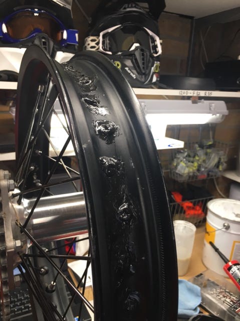

I ride in some very wet conditions. Sometimes crossing deep rivers and wading through 2ft of rain water filled muddy ruts. More often than not my rims get a good filling of water through the spoke nipples. Even when applying several wraps of rim tape/electrical tape on the inside of the rim. This is normally fine with tubes as they expand far enough into the rims recesses to stop a lot of the water getting through. And tubes are pretty resistant to wear anyway. But with mousses the gritty dirty water accelerates wear. And with TuBliss there is ample free room for water to get in and build up a nice heavy swimming pool!

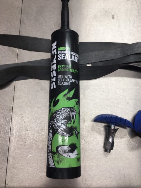

A good trick is to clean the inside of the rims and seal the back of the spoke nipples with a good quality waterproof sealant. I use Nemesis black frame and glazing sealant. Screwfix £6. It’s tough and flexible and can be easily dug out and replaced if I need to adjust spoke tension at any time.
I still run a proper rubber rim band over the top of the sealant as well and apply this when the sealant has cured so the band doesn’t stick to it.
I also use a small rubber washer on the stem of the rim locks (hub side of rim) to stop water getting in that way and I use a bolt in stainless valve from Enduro Tyres to stop water getting in the old valve hole.
Not much water if any at all gets in past the tyre bead as long as it’s clean and seated well.
