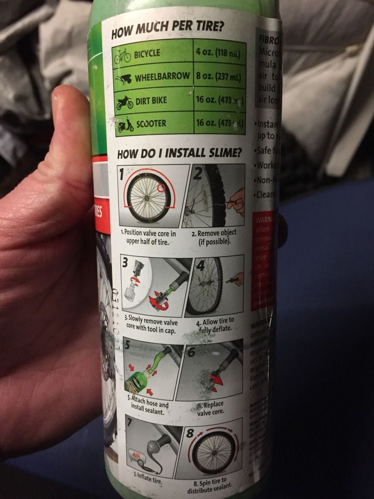

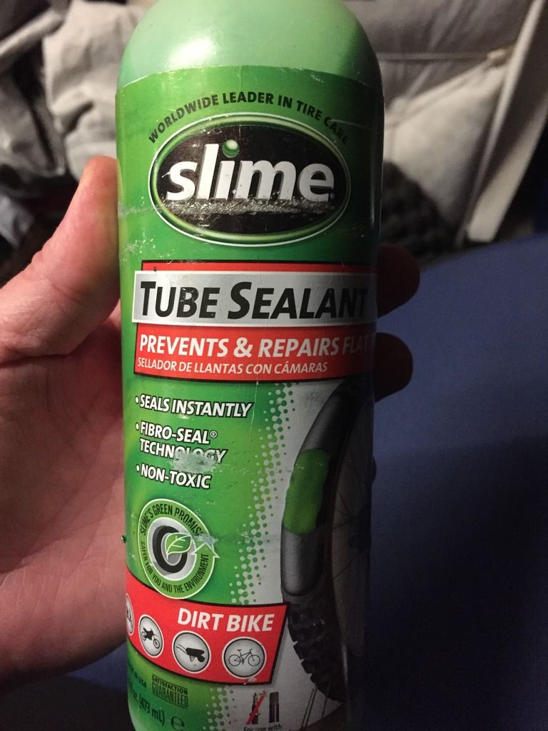

Does the slime avoid the need for a can of foam but still need a can of air?
Or will it seal enough to get you to a garage?
Depending on the size of hole, obviously.
Mike has already told me I can't use Tubeliss in my 690 and I would imagine road riding would destroy mousses (not that I want to use them, anyway).
I won't know what is in mine until I change the tyres and I'm not going to bother just having a look.
#12 ·
I've used it, its okay if you get thorns or nail type punctures anything bigger and it just makes a bloody mess, also makes the puncture hard to repair. The slime makes glueing a patch on nigh on impossible. I just wont bother anymore, I do use it on MTB
I do also carry a can of tyreweld but that is only for a real emergency
