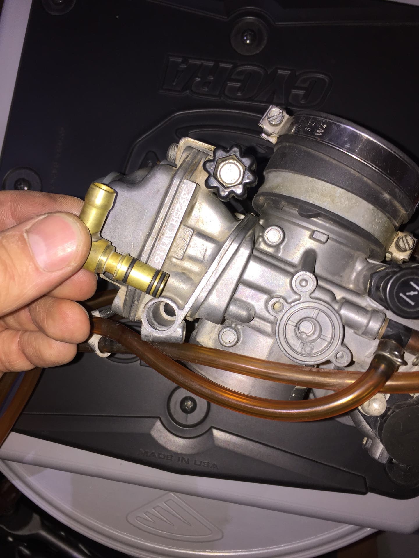

Keihin FCR Fuel Line Connector O-rings
Do these perish and cause leaking at the socket on the carb body?
Assume they a kit and can be replaced?
Are they allergic to brake cleaner being used instead of carb cleaner?
Had the thing together ready to fire and fortunately noticed it was leaking before firing it up. [emoji51]
Sent from my iPhone using Tapatalk

Miner, my old friend ;-)
Cant answer any of your questions, but I know that I have seen the small o-rings. They came with the Keihin FCR gasket kit for an EXC 450. They are not sold separately. The kits number was 57331099000, you can find it in the spare parts manual or ktm spareparts finder. Pretty sure that's what you need.

Cheers steveman, aye that looks to be the one..... half hour job turned into an age trying to find the leak and stripping, then leak testing various bits.... I was so annoyed I tidied the garage at least (eventually)!
One of the guys in our off-road WhatsApp group stays 5mins up the road from me and has a couple of KTMs and a large selection of o-rings, going to swing by and try to fit something up. Fecking 4T and their fancy carbs...... :D

I know that the fuel connections can leak, but I never saw it happen.
Didn't even know that there were o-rings fitted to the little brass tube until a mate replaced them during a complete carb overhaul.

Got some off my neighbour there, odd size as well, looks like a square ring.... either that or just now that shape. Got one thinner original one and two fatter, closest size ones in it, then seated with a little gentle persuasion. No leaks..... try it in the bike and see how it goes.
