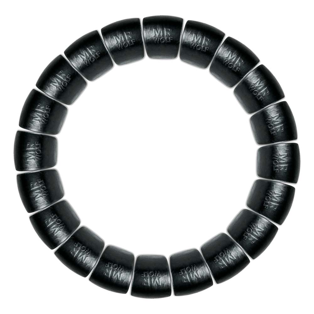

I don't race and don't ride in rocky terrain. Simply because we don't have much rocky terrain. I like the Michelin Enduro Med but it really didn't want to hold air for longer than 2 hours. I then bit the bullet and started to use tyre sealant.
Replacing the tyre is a pain as the slimey stuff makes a huge mess. My garage looked like a lost place where someone shot zombies and splattered their guts all over the place. I always have two sets of wheels, one with mousses and one with mousse at front and Tubliss for the rear...
Anyone tried this and can say something about it....

#38 ·
Yes, I have heard about such experiments but I think I would not trust them. They have a rough surface and I think that can't work for a longer period of time. I run mousses in all my front tyres.
