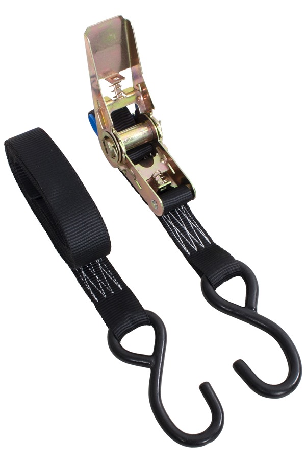

For those whom trailer their bikes, which tie down system fo you use, the ratchet strap or cam buckle strap.
Im away to buy some straps for a new trailer and would like the thoughts of the board on what you use.
Im fearfull of overtightening with the ratchet type, but also concerned if there is slippage with the cam buckles..

I’ve used both. Small ratchets are no issue. You can’t tie down too far really. Just till it’s firm. Cam type work fine.
Fit either type around fork leg in clamps or over bars. With cam types, snug down one side so the bike leans. Pull bar back over so bikes upright again. Snug down other strap. Forks usually end up 40% into travel at this point. I then tie off a slip knot with the free end of strap below the cam so it can’t slip loose. It’ll just come up against the knot.
Good quality ones are always best. Get ones that have proper clips and loops, not just hooks. Hooks can bounce free.
if i was on an open trailer i think I'd stick with ratchet straps but use a fork brace/spacer thing to stop forms compressing too far. Think Acerbis or UFO sell them but it's just a block between front tire and under front mudgaurd and 2 "wings" that push against fork tubes - easy enough to make a timber one i would think. Means as you crank the straps down it's solid rather than tensioning against a spring.
I only use a van so if it falls over it might cost me a grip but i just use cam-lock type for ease - never had a problem but always tie-off as Pindie suggesed

Always use 2 sets of straps, some ratchet ones as they are very solid, and as backup I has some that just pulls through a buckle kind of thing - just as a backup to give me time to pull over if one of the others goes awol.

I tried camlock but didn’t trust them so stuck with auto retract ratchets straps so I didn't end up with a mile of strap needing tying up.
